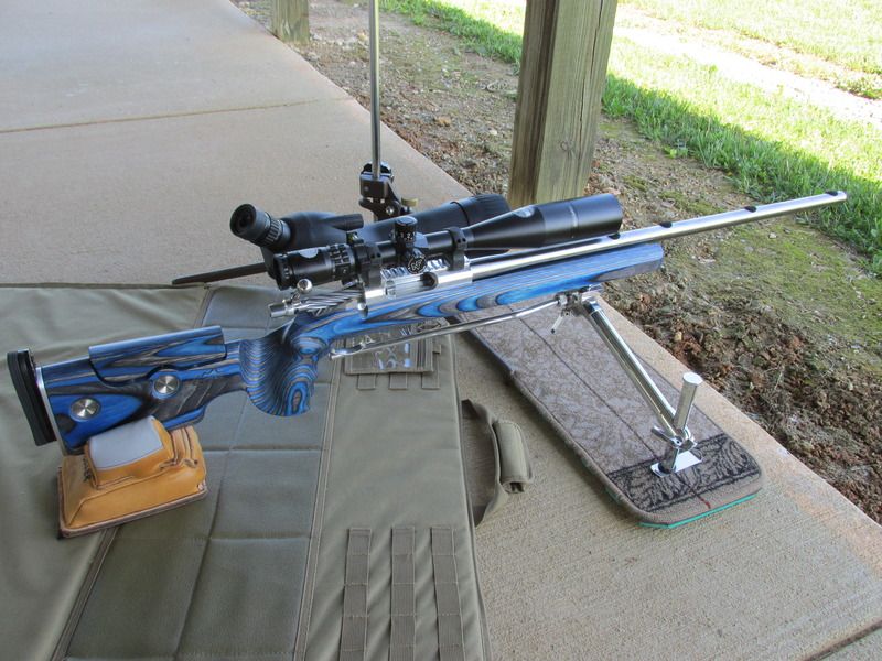

I'll try the polishing methods that have been suggested, and will practice on scrap pieces of aluminum of different grades, which I have in my shop, as I don't expect to receive the new Panda action for several weeks. Right now I need to really concentrate on the matches I will be shooting this year with my F-T/R rifle; yes, with a polished Panda action, which shoots as great as it looks... I think.
IMG_1036.jpg~original
Thanks again! By the way that stock looks outstanding, I almost have to like it because I am Irish.

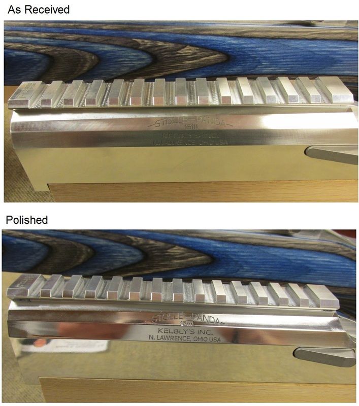

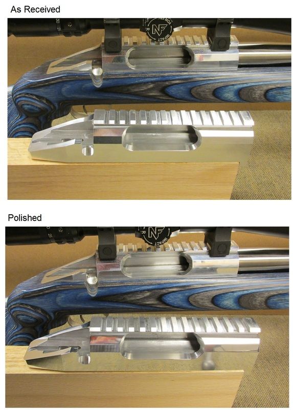

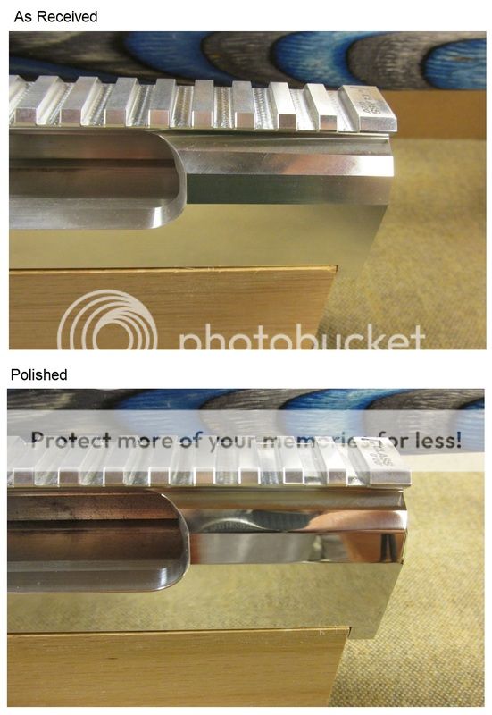

I received (picked up) the Kelby's Panda-F Action last Friday. I was very pleasantly surprised with how well it looked; and honestly, there would really be no need to polish it for it to look just fine on any rifle. Very slight machining marks could barely be seen on the action as received, and I wondered if Kelbly had done any extra finishing to make it look so nicely, so I emailed Ian. He emailed me right back and said, "That is what we call the raw finish. It looks similar to polishing, but doesn’t cost an additional $150 lol."
But, since I already had the buffing compounds (bought them at Sears so many years ago that the price sticker on the box of four compound sticks reads $1.49!), and several buffing wheels for my 6" bench grinder, I went ahead and spent about an hour polishing it. When done, I used metal polish and a rag for the final polish, and the new action looks about the same as the old.
Here are some pictures of the new action as received and as polished.
New action shown next to the older action on the rifle
I am very happy with the new action!
Alex
Congrats on a nice job, Alex;) There is nothing at all unacceptable about a nice machined finish. Pick up a can of MetallWerk Concours Aluminum Polish (available under the Wolfgang name) and you'll maintain that shine indefinitely.
Really nice job Alex. Thanks for posting the pics, I'm sure many people here will benefit by you having done so.
