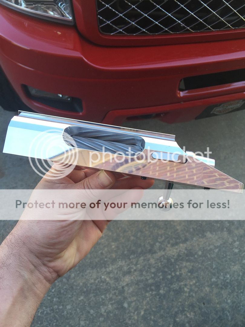

I believe mine was one of the last ones to be polished based off of conversations I had with Kelby...its a shame too because the guy did an amazing job.image.jpeg

If you're afraid to use a buffer, you can produce a mirror like finish on your action using a very fine Japanese whetstone. Be prepared to spend a number of hours on it.
OP, on aluminum I use sand paper on a granite surface plate to refine the scratch pattern and keep flat surfaces flat. work up to about 600 grit. Then on a loose muslin wheel you can bring it up to that mirror finish, just use your head and dont dwell on numbers or edges or you will round them off. I usually use green compound even though its not specifically for aluminum it seems to work great for both aluminum and steel.
I'll try the polishing methods that have been suggested, and will practice on scrap pieces of aluminum of different grades, which I have in my shop, as I don't expect to receive the new Panda action for several weeks. Right now I need to really concentrate on the matches I will be shooting this year with my F-T/R rifle; yes, with a polished Panda action, which shoots as great as it looks... I think.
