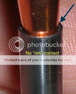

Does the seating die have a VLD stem? If not tip of some bullets may be touching in tip of current stem.
Tip is clear of the stem, seated bullet shows slight ring on tip, indicative that's the only point of contact w/ the stem).

Stem fit images…

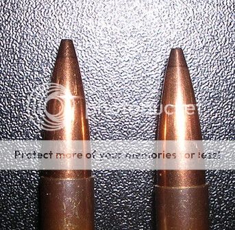

I am getting this…
Not at all sure on how-to match the seating stem bore w/ the 123 Scenar ogive profile as a means to prevent the "rings" altho Webster's post is revealing on the how-to. Is there a valid concern in "violating Wilson's warning" about not removing seating stem as doing so causes wear of the parts (stem and cap)?
In my experience the ring is a tell-tale sign that the bullets do not fit the seating stem.

Hi deadwood ! , First, I hope I'm not making a pest of myself :rolleyes: I load the 123 Scenars in 6.5X47 also. I just checked several rounds and found the very lightest sign of a ring at approx. the same position on the bullet as yours using a Forster micro-seater. When looking at your pics it appears the bullet on the left has what looks more like a scuff rather than a narrow ring like the bullet on the right. .......... To me this indicates that more seating pressure was needed to seat the bullet on the left assuming you are using a smooth, even stroke on both bullets. (also assuming the pic is a accurate representation) .............. I don't know if you answered the question about opening the necks on NEW brass with a Mandrel ? Could this be a part of the seating depth variation equation? It's very possible. ................. Next, I first used the Sinclair nut years ago when shooting 7mm BR in IHMSA competition. Maybe I'm just fumble fingered but could never get consistent measures or re-measures with that tool. Too many tiny adjustments of nut & cartridge to get the damned thing square in the jaws of the caliper. ........... I'd take several readings until I came up with the shortest possible reading for a particular cartridge. Come back several minutes later measure again and never able to get close to the original reading or, come up with a reading several thou shorter than the original reading. VERY frustrating :mad: ................ Try a friends Hornady LNL gauge and compare results. ........... Regarding the width of the rings: dollars to donuts the bullet with the wider ring is seated longer than the one with the smaller ring. Hope this helps, Dale
