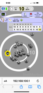

I used 190’s in a .284 this month at the Texas Midrange. This was my best target.
