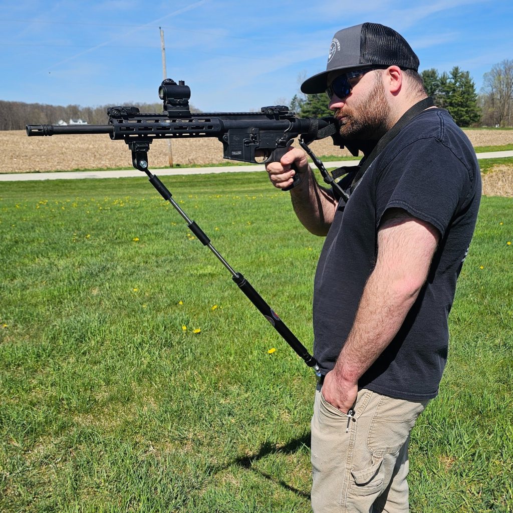

Bite operated triggers are pretty common, maybe used with a tripod type mount, depending on his ability to control the shotgun/rifle.
This site is more about neat stuff for keepning the disabled in the field

I’d rig up a firing device operated by mouth so he could still hold/support the firearm with his left arm. Years ago I made a solenoid setup exactly as described with a rubber coated squeeze switch (normally open) that the kid was able to hold in his mouth and squeeze with his teeth. The solenoid was alongside the trigger on a bracket I fabricated that had an arm that went into the trigger well and depressed the trigger. I would imagine if his right side will support the recoil that a padded pocket of some sort could be sewn onto the clothing.
This site might give you some ideas, and they have a mouth operated trigger setup
