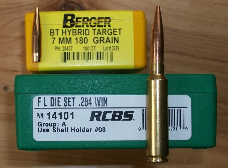

Here's a photo for you. .284 Winchester and 180 Berger Hybrid.
A 284 Winchester with a 1:9 twist barrel and enough freebore to get the big bullets out into the neck would be a great choice.
+one, I love my 284 and it's throated for the 180 Bergers. PERFECT
