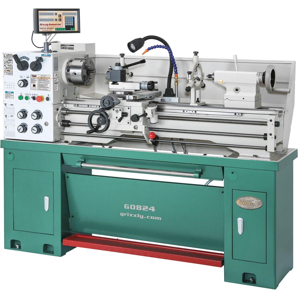

Gunsmith Lathe with DRO
That looks like it has a huge headstock. If youre wanting to chamber inside it wont be ideal. You may like the middle size grizzly gunsmithing lathe or one of their toolroom lathes

Im talking about this one. Its perfect for chambering. You said you had the 14”. Get this lathe and a good dro and you wont be held back on chambering
I'm not held back.
This is mine.
