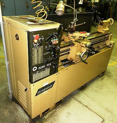

Romi used to make a great 13x40 manual lathe that a few gunsmiths had. They weren't imported for very long. I had forgotten about them. If you came across one of these in good condition they'd probably be a good bet. Very similar construction (if not exact) to the Nardini's and I often wondered if Nardini didn't subcontract them. DoAll sold their branded version of the Romi as well.

My DoAll by Romi. I believe it’s a M300 clone? Made in 1990 in Brazil I believe. I’ve seen a Bridgeport also that looks exactly like mine but blue/grey color
Definitely it's own design and not an M300. Romi and Nardini are both out of Brazil. The manual Romi's share way too many identical to near identical features of the Nardini's to not be related somehow which is why I wondered if Nardini didn't sub contract them to Romi.
