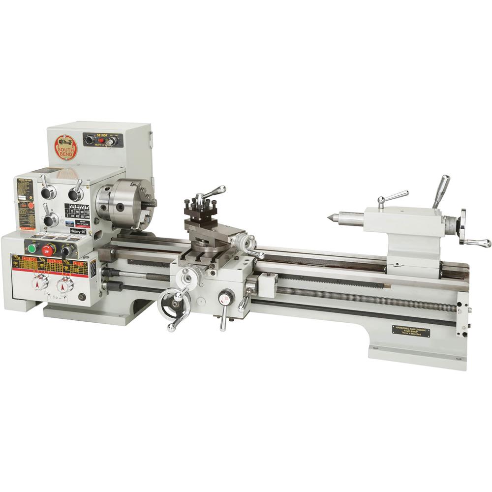

What about this one? Is this made in USA?
Made in china im sure. Its not like a regular south bend its just got the name on it imported by grizzly. Lee gardner did a write up on his on here and i think he was selling it last i heard. I think they work fine

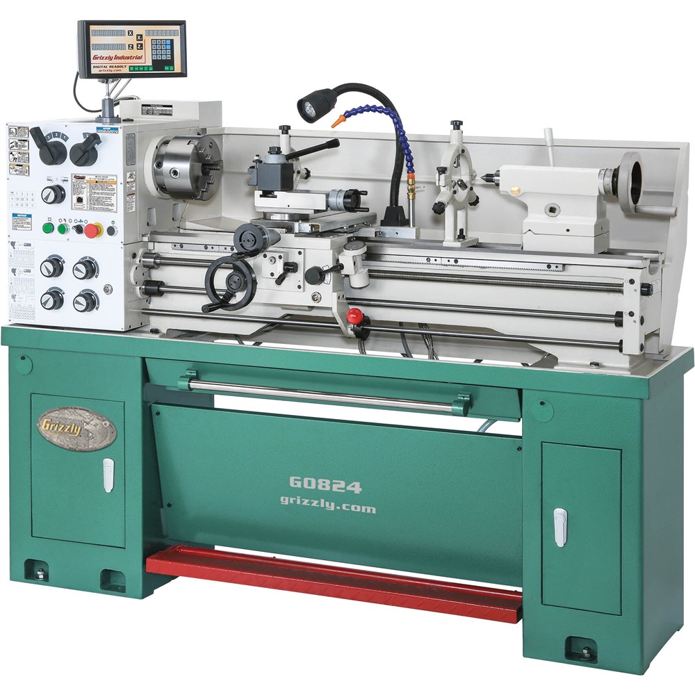

Look at the threading chart in the pictures on the 0824. You are changing gears for most imp. threads which is annoying.
If I was buying new I wouldn’t want to have to do that. It appears to be the same as my 0750G in terms of gear changes.
