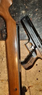

In 1970s, shot a FWB 65 when i was a Beeman dealer for a short time. Very accurate .177 gun. Recoiless too.
To beat the heat, shooting these in my cool basement, just yesterday. 20220721_102355.jpg
