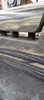

The next thing is this comb seems to be glued in this position ? Is this a handyman special idea or did they come this way ?IMG_20250131_203108655_MF_PORTRAIT.jpgIMG_20250131_202814732.jpgIMG_20250131_192052365.jpg
Jo Bob special on comb…
You can cut it off, sand everything, epoxy it back on let the glue squeeze out the gaps & voids, you’ll just have a black outline of what once was…
Marine Tex cleans up with water..
Great, that's the direction Ill go.. Still plenty of winter, I need to break it down and see what the pillars are and if there is any bedding in there. If I do all that I may try to paint this stock.
