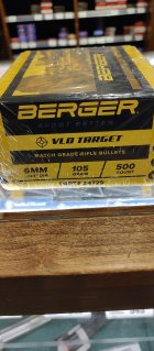

Projectiles.. Humm. if they been fired from the Lapua ammo- just get some Berger’s…

As for bullets there are a variety of awesome 6mm bullets ranging from 103 to 108 gr that shoot well at 6BR and 6BRA velocities. I do find that each barrel likes different bullets (even of the same weight) so unfortunately the way to really get maximum accuracy is to try several.
That said, if the Lapua 105gr box ammo shoots well, I'd also start with the Lapua Scenar-L 105gr bullets. I've shot both the loaded ammo and hand loaded with the loose bullets and both have performed well.
David
I would suggest reaching out to Harrells Precision and have them make you a sizing die. They will have you send them 3 pieces of fired brass. I think the cost is only about $125. Just buy a Wilson seating die. Berger 108s, Berger 105 Hybrids, or Sierra Matchking 107 all shoot very well in a 6BR.
