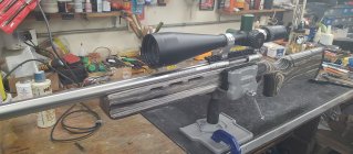

Go easy....total noob to 6BR/Norma
Im soaking it overnight in the Hoppes copper remover ?
Savage Barrels are known for fowling, I clean mine several times with
Bore Tech Cu+2 Copper, 4 oz or​
Bore Tech Eliminator Bore Cleaner​
They both work, the C4 is a copper remover, I wet patch it, let it set 10-15 mins and patch it out. I will do this several times until the patches come out fairly white. The copper fouling turns the patches blue.
If that’s what you have, go for it.
I’d snag some wipeout patch out and wipeout accelerator soon. I only use the accelerator if I’m cleaning it all at once. I don’t leave that in overnight.
If it’s really cooked in there, you’ll probably end up needing an abrasive. Also, I replace my bronze brush every other cleaning, or about 30-40 cycles through the barrel.
After an hour of cleaning my borescope still shows copper deposited in the rifling. The chamber is looking good, the barrel...not so much yet.
