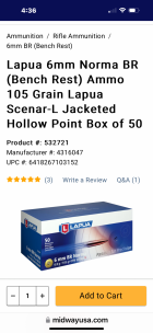

As was already mentioned, buy some of the Lapua ammo in both the 90 grain and 105 grain Scenar.
While it will be expensive upfront, you'll have some good ammo to shoot while you learn the gun and you'll have some great brass to reload afterward.
Best of luck and enjoy the journey!
Before I spend on components and tools to load, what is a budget friendly factory ammunition that will net me some decent brass along the way as I learn this rifle ?
1:8 twist/ 29" crowned. Savage dual port BR rifle.
like these guys have said there is no budget factory ammo for 6br. there isnt much factory ammo period— lapua is the only factory ammo i know of and i wouldnt call it budget friendly. cheapest way is to buy brass- lapua- peterson - adm
