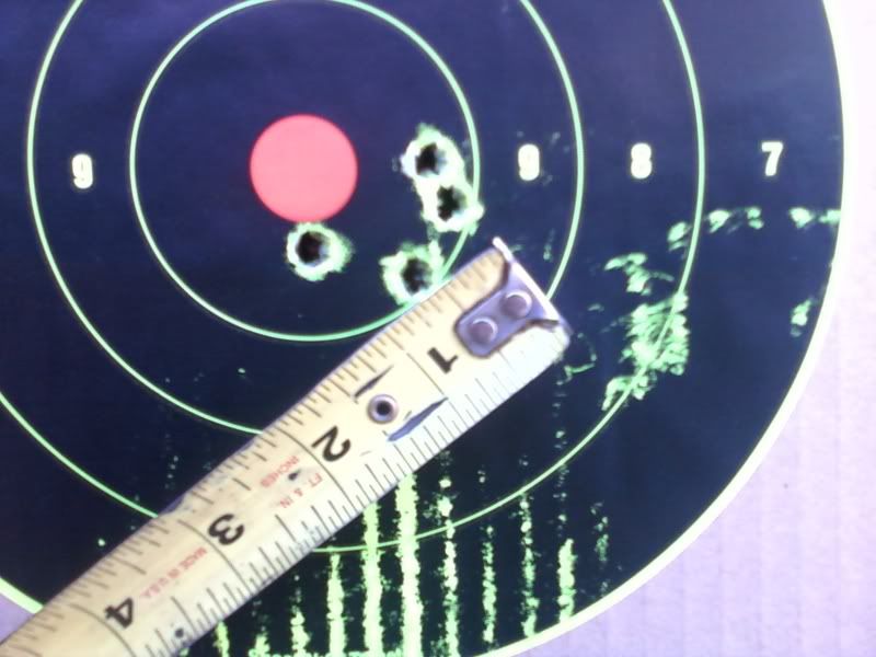

for the 'Ole Warhorse'! This is a target I fired this afternoon from 800 yards with my old NRA Match Rifle chambered for the 30/06. German mentioned it in one of his articles as one that he has been thinking about but at the time article was written I don't believe he had the opportunity to test shoot it. I did so today. Load was 53.5 grs. H4350 behind a 190 gr. Hornady VLD, Russian Large Rifle primers, Winchester cases and bullet just touching the lands. I will test this on back to 1300 yds. eventually and the remainder of test shooting with be with the seating depth jammed into the lands. I did not care about going to center here; rather just to see how the group would cluster and it did highly well. I let one round get away from me which hit slightly high away from main group where 9 rounds impacted into an area 3" vertical x 3.5" horizontal. I have not put this load through the crony. I figured today on 90F with 54% RH and used a MV figure on the Ballistic FTE program of 2650 fps which I think was a little fast because I had to come up 2 MOA from what was predicted to be near center. No signs of pressure with easy bolt lift! It is my considered opinion that the Ole Warhorse 30/06 is nowhere near being delegated to the junk heap of history! Thanks German for the load and all the work you're doing! Keep it up!! ;D :)

Great results, Rick! That 53.5 H4350 is my favorite load, usually with the Sierra 190, nice to see how well it works with the Hornady bullet!
