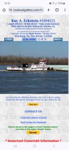

This one has never been out of Mississippi River. Marquette has a canal division so I would think you have seen one of their 2400's. I just do trip pilot work now so pretty much on a different boat every trip.
On a side note I met you at your shop maybe 1985. My dad had a boat and oil tow with a separate bow boat. Had a tunnel across it with 2 props. You made a shaft for it to convert to 1 prop. Old channel shipyard.
1985. That’s been a while back. We were about a fourth as big as we are now.
I see quite a few Marquette vessels in the area. We do not do a lot of their work because they use Crumpler Machine, which is in Bridge City.
