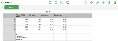

Following up on this, I broke into a new case of 5,000 and pulled a sleeve. Personally, I sort in 0.02 gn increments (the resolution of my scale), and it gives me a reasonable number of "buckets" to work with, but after seeing these results, I may switch to 0.002 gm buckets. For those that weigh-sort in grams, do you group in 0.001 gm increments? 0.002? 0.003?
Here's what I found with a single sleeve of 100;
