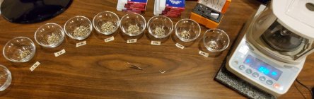

Those other variables are why I did testing to see what difference there might be, if any. Other's have run tests showing that the outliers produce a discernable difference. Running the tests myself convinced me that there's enough difference to warrant the effort in sorting. . . for me.

If going from consistent SD's of around 9 to consistent SD's of around 5 isn't important to your shooting discipline, then sure. . . don't bother sorting primers. And I think this is so for the vast majority of shooters.

So forgive my stupidity, and I'm not trying to highjack the thread, but can you sort 100 at a time and just put them into lots, or would it be better to sort all 1000/5000 at the same time?
Also, if you only have a scale like RCBS link or the like, is this even possible? I just weighed 50, 205m and got 3.6-3.7gr.

I do 1000 at at time typically so that there is enough of a lot to be useful in a match.

I think one could probably doo 100 at a time, but would need to record the results each time in order to identify any outlier that pops up. The main issue I'd have with just 100 at a time is not having enough within a small weight range to get 50 or 100 rounds loaded. So I think doing 1000 or more is the better approach.
Though the resolution for that RCBS Link isn't be best for sorting primers, I think it can still be somewhat helpful in finding those few outliers in a batch . . . even if you're only weighing 100 at a time (as long you keep track of the weights so you can identify an outlier when you see it). And I think it would still help to keep those those weighing 3.6 an 3.7 apart. In other sleaves of primers of the same lot, I think you're likely to find a few that are outside of that weight range.

When I started sorting them, I was quite skeptical. I didn't want it to work at all because it is kind of a pain and uses time I'd rather spend doing something else. Ultimately I did catch some outliers. My SD/ES did go down. I did start shooting better. Is it because of the ammo? Or is it that I'm just getting better? I'm about a year and a half into shooting F-Class.

A quality scale is a must FX120 set to grams will do the job, I store them in the original sleeve and sort one brick at a time
