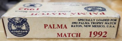

First year Sierra 2155
Doing Winter projects, I found four boxes of Sierra 155s (2155 - the Brick) and noticed three of the boxes are marked "1992" on the ends, along with all the usual markings. Is there anything significant about these, compared to other 2155 Sierras? Other similar boxes aren't marked with a year.

Just the usual box-end label but on the RH side is a rubber stamp of the year. Nothing too unusual but I've never seen that noted since. I'll likely just load them as usual if they're not anything special.
I agree! Nope, just oddly marked components that'll likely be fired in my Palma rifle.

You are right that Palma is a standard competition with some equipment parameters. My Palma rifle conforms to those International rules. There are domestic US Palma rules as well. Typically, the Int'l game has been fired with 308 cal rifles under a given weight, firing bullets no heavier than 156 grains, with iron sights. Sierra cooked up this bullet for issue at the US Palma gathering in Raton, NM in 1992. US Palma allows 223 cal rifles with no bullet restrictions. Barrels in 308 run about 30 inches, with a 1 - 13" twist, or thereabouts.
1992 was the first year the Sierra 2155 was the required bullet for all countries, match was shot in Raton. Only valuable as a collector item to someone who cares about Palma or Sierra.

Although 223 Rem is an eligible cartridge, the international match competitors have never used it AFAIK, so 308 Win only, and in the international match, bullets must weigh 'less than 156gn', ie 155 or 155.5gn commercial models. This rule was introduced in 1992 and IIRC, at that time the host nation supplied ammunition to all teams, the US supplying it loaded with the original Sierra 155gn MK #2155. In recognition of Sierra's efforts in designing the bullet, supplying it and assisting in the ammunition development, the company was granted the privilege of using the 'Palma' name and emblem (based on the Palma trophy which in turn is based on ancient Roman standards) on these bullets - since moved to the later #2156 upgraded design.
