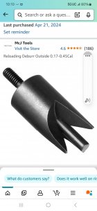

I use this one on a Lyman express prep machine. I like it better than the Lyman tool that came with machine.
