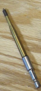

K&M advertises that their tool chamfers as well as deburrs. I suppose that many reloaded just use a tool like that lightly, so that they don't end up cutting into the brass to chamfer or enlarge the flash hole, but I guess I might ruin some brass accidentally chamfered the hole when I don't want to.
The Wood River pin vise from Woodcraft.com, plus a drill bit of an appropriate size, looks like an interesting potential diy solution.
I used the K&M tool on my 220r match brass for many many moons and have yet to Ruin any brass...

This is what the head of the K&M looks like. The chamfer looks minimal and there is a stop to set the depth. The shaft of the tool has a collar to also set depth if desired. This would be the tool to do what the OP is asking.
