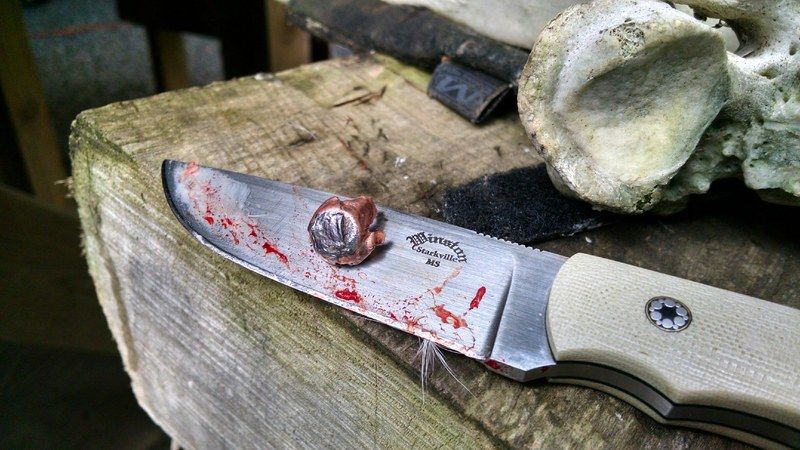

Wondering what load and barrel length your running? That's pretty speedy for the 223 case. I shot several deer last year with the 6/223 also, but with the standard 70gr Nosler BT. With 24" barrel I was pushing right at 3100 with a pretty firm load. Bullet worked well but not many complete pass throughs. Could have used a better blood trail on a couple but none went very far at all if they did sprint (most folded). The bullets I did recover held together surprisingly well (for a varmint bullet). Following picture was pretty typical when recovered...
Wondering what load and barrel length & load your running? That's pretty speedy for the 223 case. I shot several deer last year with the 6/223 also, but with the standard 70gr Nosler BT. With 24" barrel I was pushing right at 3100 with a pretty firm load. Bullet worked well but not many complete pass throughs. Could have used a better blood trail on a couple but none went very far at all if they did sprint (most folded). The bullets I did recover held together surprisingly well (for a varmint bullet). Following picture was pretty typical when recovered...
