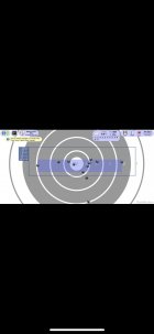

Hi running my first 6 mm br in my barnard S action
bullet weight 108 grain
berger 108 BT
Brass laupa 6 mm br
Powder H4350
Weight 34 grains
primer federal gold medal match
velocity 2885 fps
barrel lenght 26”
freebore unknown tbh
ran a few rounds down the new barrel tested some loads at 150 yards 5 shot groups started left to right 32 grains up to 34 grain looking good so far . First shots at 600 yards showing good elevation 33 grains moved up to 34 grains again looking good to me

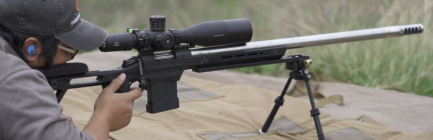

Had my 28" Bartlein 6BR out a few days ago to test a project I've been working on... New revolution stock that I opened the barrel channel up with plenty of clearance for a 1.2" straight barrel and fully bedded with 10110 for a single shot TL3...
No load workup for these 106 A-Tips, just loaded them with my 105 Hybrid load 0.01 off. I'd say she's shooting
