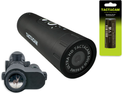

What is the best/easiest cam system to attach to a scope? I think for hunting it would be great to go back and review the shots.
Tactacam. I have this setup with a 5.0 camera. They recently released a 6.0 camera. Works great.
