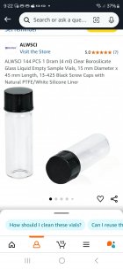

They look like centrifuge vials like we used at work. They come several sizes. Probably pricy if you buy them from a chemical supply store.
I think I paid $12 for a pack of 100 of the 4ml on Amazon and about $10 for a pack of 25 of the 10ml

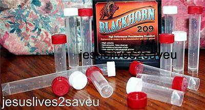

If this link to ebay isn't allowed, I apologize. I am not affiliated with this seller but have bought numerous plastic vials from him for my muzzleloader needs.
They may be too big for you guys although the 25ml isn't huge. You can mix and match sizes and he sells cases. I get the screw on lids and flat based ones. They are sturdy and seem to seal decent. I haven't had moisture issues or anything with black powder in them even from year to year.
Just thought I'd pass it on.
