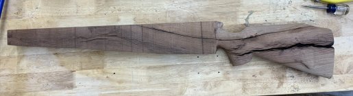

Yes. Hand applied Arrowood, but as I suggested in your thread, I sanded it past 1000 grit BEFORE I put oil on it. Oiling at 400 leaves you wet sanding to get a glossier finish. You can easily leave it dull, which I think is adequate for a hunting gun.
I put a heavy “soaking” first coat on and let it sit for half an hour. I did another light coat and let it sit for 2 hours, then hand rubbed it for 10 minutes. It’s already looking glossy.
Well, thinking back, I’d say 20 to 25 hours. I use a router for the inletting with various bits. An old drill press for the one too many action screw holes. I have a router table with a 1/4 rounding bit for the 40x style fore end and then I started sanding the final shape. I use a rotary disc and palm sanders . It’s a little easier for me, since I’ve done so many. I shape the butts and grips by eye, mostly.
Sanding it to-2500 grit
I rub it for 1-2hr, then put a light dab of mothers aluminum polish on it-
Rub another 30min-
Will be glass like !!!
