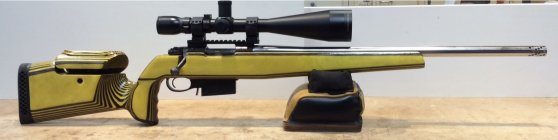

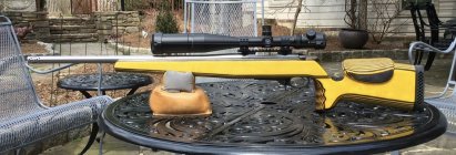

I made a stock a few years ago with bumblebee laminate and left the outside yellow. I was feeling it was a bit too loud, so I sanded the yellow off to the next layer of black. I’ll hit it with some black annaline dye and redo the epoxy coating.

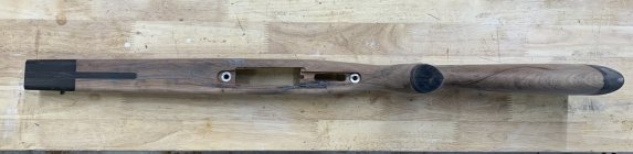

I finished shaping the Mesquite stock. Did a taper from the lug to the tip. Just pushed it thru the table saw, then sanded it smooth. I used a 15 degree router bit along the top sides and a 1/2 radius along the bottom. I used the big disc sander to angle down to the grip and the palm sander for final shaping. Now I’ll fill any cracks I exposed with an epoxy mix with turquoise dust.IMG_1961.jpegIMG_1960.jpegIMG_1959.jpegIMG_1958.jpeg
