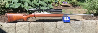

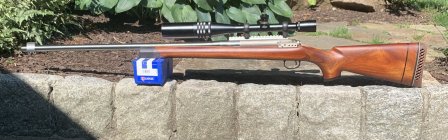

Years ago, I had a bunch of barrels cut by Bob Green for a Kodiak action. I was friskier then and did the switch-barrel thing. I made a rather heavy stock for it out of Epe in the Tikka Master Sporter style. Wanting something lighter and different, I took a 40x stock I had duplicated out of Mohagany and “adjusted” it to hold a new Kodiak action I found on the Sale board. In retrospect, I should have started from scratch and avoided adding extra pieces. The finished stock is functional, at least. As usual, sanded to 1000 with an Arrowood oil finish.IMG_1707.jpegIMG_1706.jpeg
Kodiak RBLP Hunter configuration with a Lederer 6br .269 neck throated for Berger 105s. The bolt is at Kelbly’s getting an ejector installed. Ya gotta like quality customs, where parts are interchangeable. I’ll use the bolt from my other Kodiak while I wait.

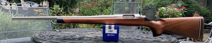

Started another 40x copy. This one gets a Sportco action barreled in 6 Dasher. Continuing my mental break down, I drilled the pillar holes in the wrong locations!:mad: I measured 3 15/16” and marked 2 15/16” from the tang. Where’s my plug cutter? If this continues, I’m gonna hang up my apron.IMG_1712.jpegIMG_1711.jpeg

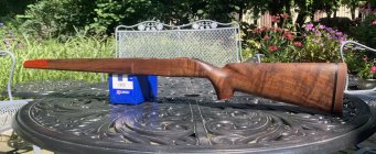

Finished the 40x copy in Mohagany. Last year, I bought a Sportco actioned 6 Dasher in a prone stock. I didn’t like the Mastin stock so I sold it. This will ride the bags better. I moved the action forward 1/2”, then cut the stock for a 13 1/2” pull. Didn’t feel right for my longer arms. I usually make my stocks to fit “everybody”. I added an inch back onto the stock and it feels better. Arrowood oil for the finish.
