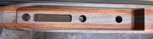

No specially tool in my workshop . Here's a picture of another stock that has a few layers of carbon fibre in it . 1 in the machine getting shaped and the other ready for some filling then hand shaping to finish off. I also apply west systems thinned 10% with acetone to my stocks after sanding to seal the timber the first time sanding.
