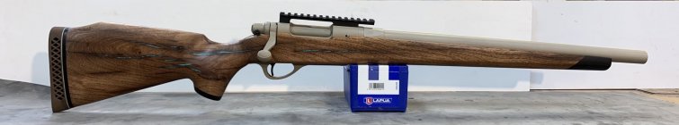

Spent the morning putting the gun together. The action is an old 600 that had been sleeved. Thanks to @hogpatrol , @Markman and @nilebartram for the help getting the parts to put it back in working order. One part I couldn’t find was a bolt release button that worked with the Timney trigger so I did a little Redneck Gunsmithing with a piece of brass rod. I got the hole for it drilled right on the first try! Sending the metal out for ceracote in tan. Nutted barrel in 223 from @urbanrifleman .F803C40C-E14E-4A0A-83C8-CD1C899F6810.jpeg53D4878E-E9F7-45ED-A876-A4AFBB2A4A45.jpeg2A6A70B4-D320-43CF-8FDA-B8A3FC45A473.jpeg7E7E3301-4F3E-4D9E-A6FF-6EC28A65CE0B.jpeg

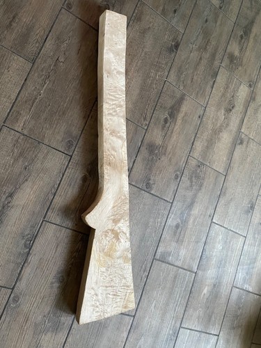

That’s pretty wild. There’s a Maple blank on eBay with a bunch of cracks. Filling them with something like pearl orange would look cool…but $400 for a blank with cracks?
Looks more quilted than curly.
Beautiful piece of wood.

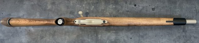

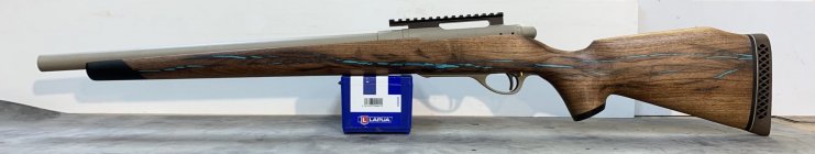

I just got the old 600 back from getting ceracoted. I can’t say enough about how happy I am with the job they did. The action had lots of deep scratches all over it from being sleeved. They took the time to polish them out and make the action look like new again. If any one needs ceracote work done, I highly recommend Milrad LLC in Brookhaven, Pa. With only minor begging, they had it done in a week! Great outfit!DB1CB8EC-7A37-4BC4-BCE4-0C6FAACE8342.jpeg4E5D15E8-EDB1-4CC2-99CA-F92EC3C20698.jpeg51336B0F-7445-4231-BA04-5FBC474303FD.jpegEE0DA3B1-3421-4DFA-B25A-29E7BCBB3E46.jpegDFAAFD88-FE50-4626-9E42-5A091C488351.jpeg

Add: Here are some more pics. I tried something new with the 40x stocks. I left 2 flats to work from. I’ll see if it works for me.
