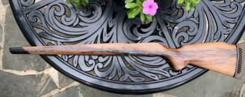

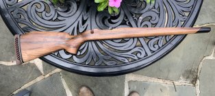

I just finished reading the entire thread. Absolutely fascinating. I want to try a few semi-inlets and/or secondhand stocks for new barreled actions first. I have a couple of BR semi-inlets for Mauser actions (I want the look of an old school bench gun. I have a Unertl scope for that build, too). I have Dave Wesbrook’s book on stock making. This thread inspired me to buy some hand tools.
That’s nice to hear. I tried to include everything. The added comments and questions kinda jamb up the explanations, but that’s life on the site. It’s for the tinkerers, hobbyists and guys that can’t or won’t pay $600 to $1000 for a nice stock.
