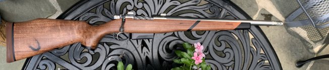

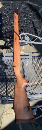

Here is a tip some of you may find helpful. Since moving, I don't have a good setup for doing stock work until i get walls put in my shop but I needed to inlet for a handstop rail.
So, what I did was put blue painters tape on my stock blank and pressed it hard so the glue stuck as hard as possible. Then I cut 3 pieces of wood to make a router template for the edges of the inlet. Using accelerator, I superglued the wood to the blank and made the inlet with a router. The blue tape pulls off easy. Since it was a one off, I bother to take the time to make a legit jig. Just make sure the jig is secure.
Or glue a piece of hardboard down and use it to rough shape the comb even.
