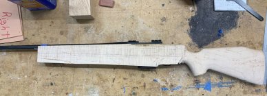

It sure is ! I’ve been cleaning up little details for days and now I’ve gone as far as I can. The good part is I picked up a 3” bench grinder that came in really handy for trimming actions screws and buffing down one side of the trigger guard.
Jim

in the last two stocks i did ive done the pillars out of devcon. i think it will work better. of coarse they are target stocks so i dont care if they dont look pretty and a little devcon shows
I screwed up. The barrel channel wasn’t deep enough. Removed another 1/8” and took a pic. Then I cut for the trigger, magazine, bolt release, etc. and drilled for the pillars. Waxed up the action and bedded it. Then I screwed up again! I forgot to take a pic! Oh well!
