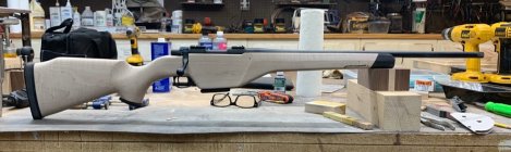

I have been inspired…….not sure how it will look when done but myself and my dad decided to build a couple short range benchrest rifles for U.B.R. And figured we’d give stock building a try. I had some old (from 40’s) walnut and some cherry so decided to give it a shot…..just getting started but enjoying it so far.
Thank you to this community what you create and the knowledge you freely share with us is truly amazing and provides me with the confidence I might actually be able to make this work.
Was finally able to get back to work on this and made a little progress today with dad’s help…..probably more like he made some progress with my help. Still have a ways to go but getting closer.
Looks good! It’s nice that you and your Dad are doing it together.

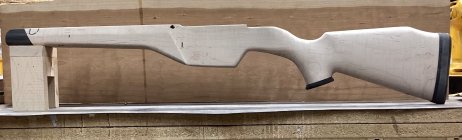

Yesterday, I routed an 1/8” off the sides of the action area, using a core box bit at the transition to the wider fore arm. Then I put a 3/8” round on the bottom of the front and a 22.5 degree cut on the top. That left a transition I had to sand by hand.
Edit: The misalignment of the side cuts was fixed.
I spent today rounding off some corners and shaping mine. I used a palm sander with 120, then 220 grit. Then I attached the butt pad and set the grip cap in some thickened epoxy. I do my tips a little differently. I route a channel for a center piece and epoxy pieces to the outside of it. Finding blocks of ebony is near impossible, these days.

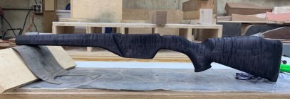

Mind the mess in the back ground not much bench space left in my home workshop. Sprayed this 1 today while it was a warmish day . Will sit on the stand for a few more days yet. How wildcherry candy concentrate in sg100 intercontinental with 8 coats of challenger 2oac clear over it .
