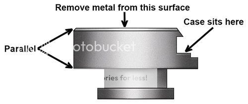

SO the plot thickens I managed to hit the shellholder with some sandpaper on a glass table with some wd40 on it doing figure of 8. If you look at a shellholder from above it looks like a C on top right, so I measured the thickeness at the tips of the c and wrote this down I didn't measure the middle/back part of the c as I assumed they were the same thickness all around. So ive been sanding away measuring the tips of the c and sure enough it is reducing down. I didn't pay any attention at the start but the middle/back of the C is a fair bit thicker than the front so its kinda sloping downwards if that makes sense. Can anyone confirm with a redding shell holder that is not modified if it is the same thickness all around the C ie dead flat on top?? If this is the case for some reason the sanding has only removed the tip part of the C and not the back so if someone can confirm they shellholders should be same thickness all the way around with no downslope I will have to modify it to flatten it.

hi alex I'm not sure 100% what you mean. I meant if you look at the shell holder from the side, the metal is thicker at the opposite side to where the case goes in and thinner where case enters the "mouth" of the shell holder if that makes sense. Ie It is sloping downward from left to right if you were looking at the shell holder side on with the shell holder mouth being on your right side
The top portion of the shell holder should be parallel to it's base where it sits on the ram. Like Alex said, from the top to the surface where the case sits is .125", at least on the ones I measured. That surface should also be parallel to the top. The purpose of sanding it on glass is having a completely flat surface. There shouldn't be any sloping.
Side view of shell holder
T-shooter yup that explains it thanks, ive F^**(D it up. Mine is not parallel I have removed far more from the right side then the left side so mine is sloping downwards. Only I could stuff that up sanding on a glass table doing figure of 8 lol. anyway I will see how I can best get it parallel

Normal rookie mistake when sanding something down on glass or any surface for that matter. The thinnest areas get the most material removed.
Now you know where you went wrong you can address it by holding the case holder in a way that loads up the thicker side a little more and mic'ing often to follow your progress. You can always back the die out if you end up way past your sweet spot.
