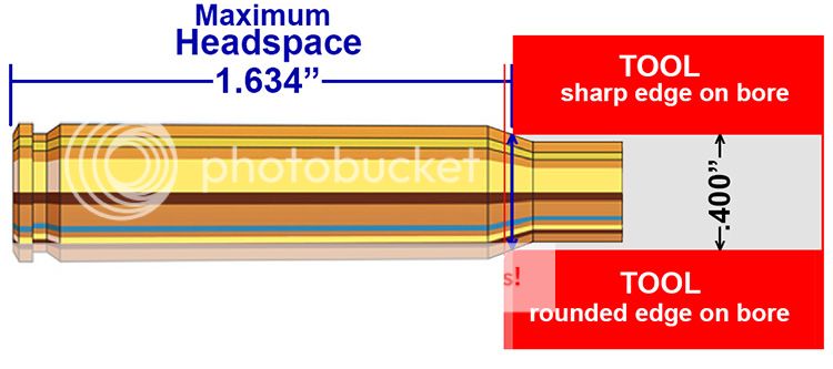

You can't use those tools to measure the headspace correctly. They aren't accurate enough They are good for comparisons. For instance, on a .308, the point to measure headspace is a diameter of .400" diameter on the shoulder. If your comparison insert had exactly a .400" bore and the edges were sharp, it would be very close as long as the case was also perfect. The problem is the bores aren't exact and the rear edge of the bore has a radius. That will allow it to sit back towards the primer end of the case more giving a shorter reading. Like in the drawing below, the difference of a radiused edge allows the tool to go back the distance between the red and blue lines even if the bore was exact the correct diameter. I recently checked the same case in my Hornady comparator and a friend's, (the exact same Hornady tools) and got two different readings several thousandths apart. There are production tolerances. Once you have a case that is correct, measure it and use those specs to compare to any others. My .308 insert measures the headspace distance a full .020" shorter than the normal specs.
