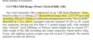

Also noticed that the NRA has updated their barrel length and scope restrictions to match the CMP's. 22" and 16x now allowed
Can you point me to that rule change? I received an email on 03/07 from Andy Farmer and he told me that, at that time, the rule was still 15X. I have been shopping for a new scope and finding a SFP 15X scope is hard without spending over a grand. Thanks in advance.
It's in the 2025 rulebook

I am really happy that the NRA adjusted their rules to match the CMP for barrel length and scope magnification. I believe the difference was causing some confusion with some of the newer competitors.
Also, with most range is going to the shot marker targets to 22 inch barrel will very likely help some of us, especially at sea level make it to 1000 yards supersonic.
I do wish the NRA would have specified whether dialing down and taping scopes is OK or not.

I don't know if things have changed in the last couple weeks but, I spoke to Andy Farmer a couple weeks ago. He stated that, although the scopes were limited to 15X, they were contemplating a provisional rule allowing 16X. When I asked about taping, he said words to the effect of, "we understand that CMP allows that but, we don't"
