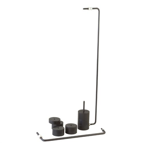

So how does a match director test it to be sure it meets the 4.5 lb requirement. I assume it won’t hold a 4.5 lb weight ?
Yes it does. They have a check weight on a metal hook that goes on the trigger. Then you pick up the rifle vertically and see if the trigger holds the 4.5 pound weight.
It is the total pull of the two stages that is measured. You are still applying the 4.0 pounds that got you to the second stage, it is just another 0.5 pounds over that to get the sear to break.
A 2 stage trigger is additive. First + second stage weights = total weight. The weights are set independently. Most of the time in an AR the first stage weight is set by selecting an appropriate weight spring and the second stage will have a progressive weight adjustment. Ala Geiselle NM 2 stage or MK 2 stage, etc. Other 2 stages (like a Rock River) are completely set by the hammer and trigger spring stiffnesses and the 1st and 2nd stage weight bias is set by the trigger geometry.
