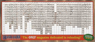

There is a third factor missing. You need to have a bullet that will transfer energy to the target at 1834fps. Most will not transfer much energy at that distance. When I say transfer energy, basically we are talking penetration and expansion. I need to find an image of a test someone did long ago that shows expansion of bullets at a bunch of different velocities. It's very eye opening.
So the bottom line is you have to find a bullet that will both penetrate and expand at 500 yards, and do the same at 50 yards. At the velocity you need to reach out to 500, most bullets will explode at 50 yards and just wound the deer. As @dantiff2 mentioned, that's a tough ask for a bullet, but the ELD-X will do it as will some of the premium bullets.
The other pitfall of hunting deer at 500 yards is being able to track and find the deer after the hit. The likelihood of error in shot placement, wind drift, bullet performance, and foliage in the path of flight is high. You will need to practice your shots from a tree stand in the same setting as your hunt. Even then, it's much harder to track, or even find the location of hit at 500 yards. All things to think about and keep in mind. There are a bunch of things to do to minimize this risk, but we are only talking bullets here.
Edit: Here is that image of the expansion test. I have a higher res version somewhere. It will take me longer to find. But note how few bullets made it to 1800fps expansion. The tester stopped testing the bullet when it failed to expand. Most bullets started to do this around 2000fps. Another thing to note is the failures of bullets at the top end velocity.
Hammer bullets' specification for minimum velocity while retaining complete terminal effectiveness is 1800 fps. On deer sized game with 3000fps muzzle velocity for the 151 AH, I would expect a pass through with full expansion at 500 yards.
