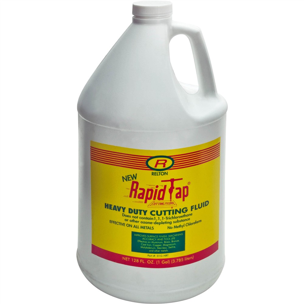

I tried all of the oils and ended up with the best one being plain old Rapid Tap.
For threading I use the clear Rapid Tap.
