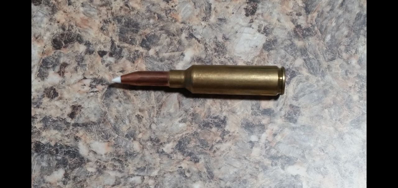

Cold weld, bullets stuck to case neck
Dusty,
What do you recommend for ammo that may possibly sit for a while before being shot?
Clean the necks real good after sizing?
Coat the inside of the neck with something?
I have experienced the “cold welding phenomenon” in the past also and would like to avoid it.
Thanks
Gary
I found that a q-tip wet with Lee case lube swiped in the case neck and allowed to dry works for my hunting ammo that sits on the shelf. Had some 338 cold weld so bad one time that it deformed the bullets when seating them deeper to break the bond. No problems since using the case lube inside the neck. IME
