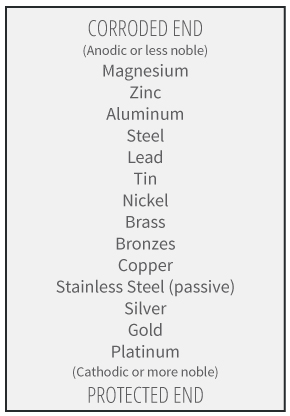

Dissimilar metals reaction should be visible on the bullet and neck.

Dissimilar metals can react and switch electrons and eventually "weld" to one another. Galvanic corrosion, electrolyic corrosion, electrolysis are other terms for it. Leaving the carbon from firing in the case necks is a buffer to prevent it as is a dip in graphite lube or HbN etc. Anything to keep direct contact between the two metals will help prevent it.

Cold welding, or galvanic corrosion is real.
Many moons ago, I would clean necks with a brush wound with 0000 steel wool. In as little as a fortnight, my pressures would spike throwing my node out and ruining my scores. This was solely caused by the above.
