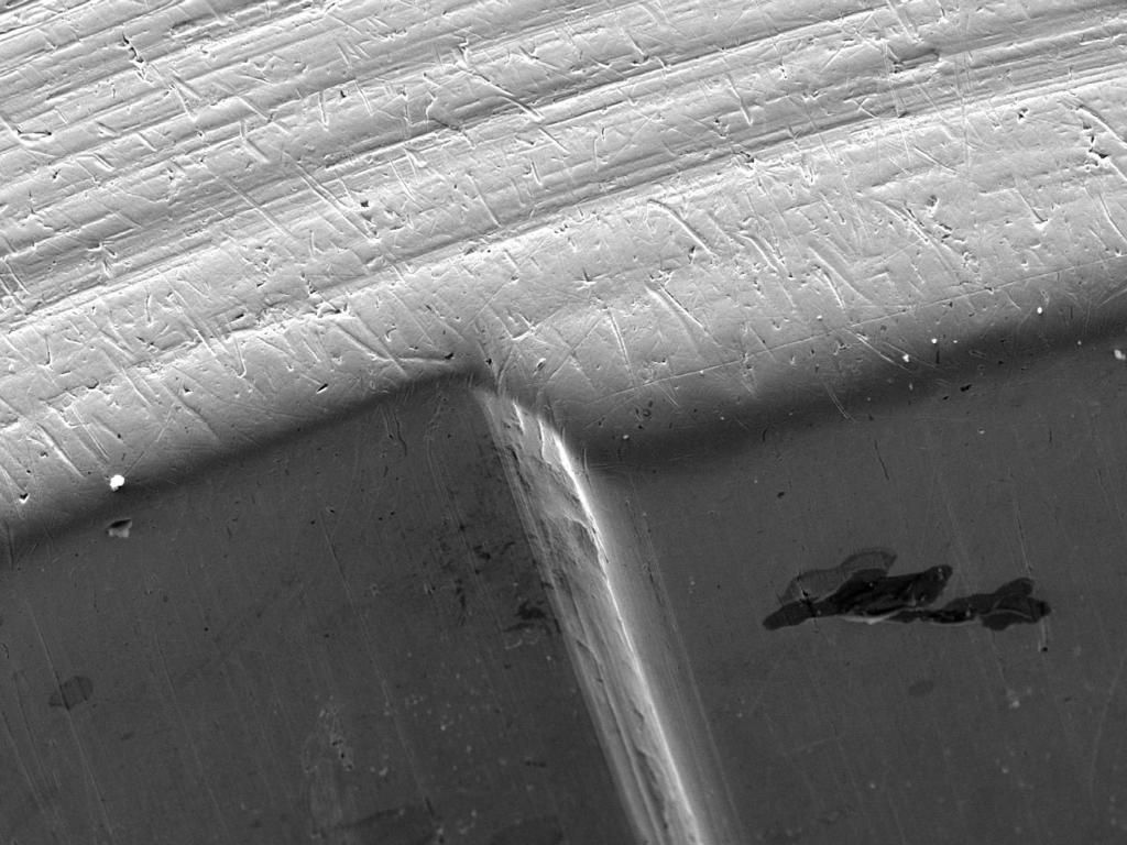

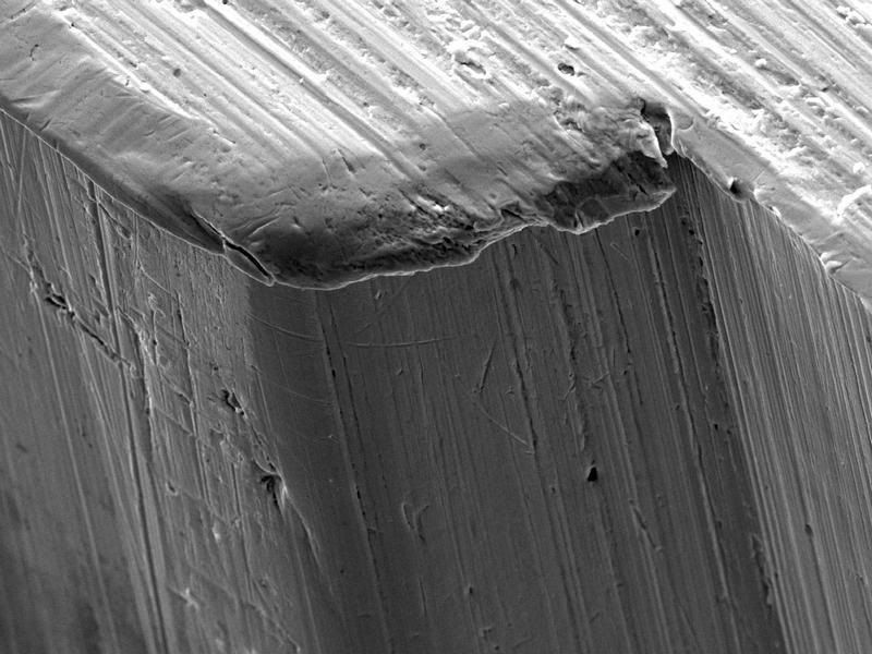

Here's a pic that I borrowed from another site, by Greg Walley of Kelbly's, taken to examine brush damage...or lack thereof. It's important to remember that the land to groove depth is about .004", or the thickness of a human hair. This should put the scratches from brushing in perspective.
Oh, and the pic below it is a similarly magnified picture of a fresh crown(brand new)..again, expertly done by Kelbly's.

Sounds good - even sounds right - BUT - I've never followed that laborious method and my precision rifles seemed to have survived 40 years of shooting - of course I've never set any benchrest records either. :( - BUT I've manage to take a ton of groundhogs and predators at some respectable ranges. :)
I think you can make this hobby as painful as you like to give you a sense of well being but I often wonder if some of these laborious procedures really have any value. Still, I guess it's interesting to debate such things. :D
