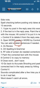

Side note.
Spell checking before posting only takes about 15 seconds.
1. I type my post in the reply area into word first.
2. If the text is in the reply area. Paint the text with the mouse. Hit control V to put it in memory > Control X to delete it from the reply area.
3. Open WORD paste in WORD by Control V. You can add or delet sentences if needed.
4. Ck Review
5. CK Spelling & Grammar
6. RT side of screen do needed corrections.
7 Paint the corrected text with the mouse
8 Control C to copy to memory
9 Close word , don't save
10 Go back to Accurate Shooting and paste the corrected text in the reply areas by hitting Control V.
Sounds complicated after a few tries you learn to do it real fast.
Word doesn’t catch all errors.
Surprised you fancy process didn’t catch this obvious error; LOL.
