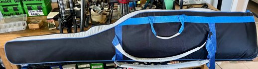

Would anyone have one of these cases that would be able to snap a couple of pictures from the top/ inside? Various angles.
Find it hard to believe they only show a side view of these cases.

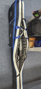

Follow up. Case arrived today. There is no way my LRB with High rings and a Majesta will fit in this case. Not even close. Won't zip and top turret will not clear zipper. Probably will be up for sale . Bulky alot of foam but not made for me. This was the 58 inch.
I have one for my 17lb. Make sure the butt is all the way back.. squeeze it shut by hand.
when mine was new i was afraid of breaking the zipper so i left it open a little at the objective.
Now, 4-5 years later it fits fine.( Stays in the case 24/7)
