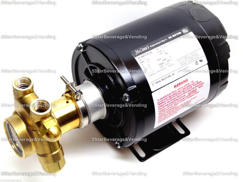

The Carbonator pumps along with an adjustable relief valve make a good solution imo. Those pumps are expensive new, but turn up used on eBay fairly often. I paid <$100 for mine.

There are still some of these kinds of kits available on eBay. Here is one example:
Procon Pump & Motor Kit
I am not a plumber but can, of course, screw stuff together. What is needed to regulate the pressure to an appropriate level for chambering?
Call and make sure they are in stock. Penn has a habit of taking your money and then telling you a few days later something is back ordered. MSC carries them too. There were similar valves on eBay for less $$$. I found a Teel for ~$25.
