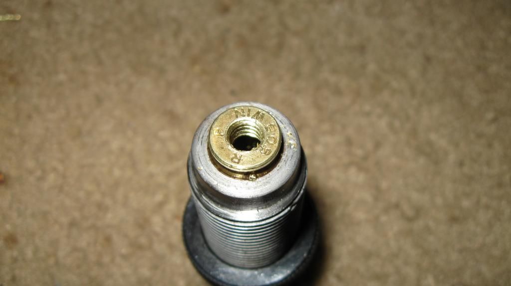

Case stuck in body die- can't get it out.

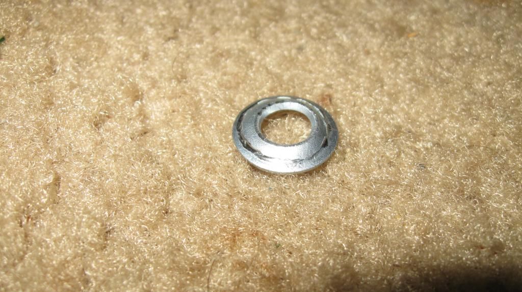

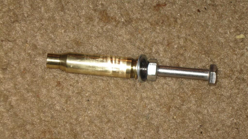

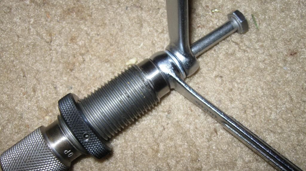

Thanks for all the great replies. Bought the die in to work today and drilled and tapped the case for a 1/4x20 bolt, used a few washers as a spacer and she came right out.

If you have a 1/4" X 20 or 28 tpi tap with a #7 drill bit, a socket wrench set, and a 1/4" X 20 or 28 tpi bolt that is about 2 inches long you have a stuck case tool. A 13 mm or 9/16" deep socket works perfect for 5.56 ammo but you will need a 3 inch screw with lots of threads on it. Just drill out the primer pocket, tap the case head, put the socket down over the head of the case and rest it against the base of the die, then insert the bolt and start tightening. I've done this so many times with military brass stuck in my die I can't even begin to count that high. Super simple way to get a stuck case out.
