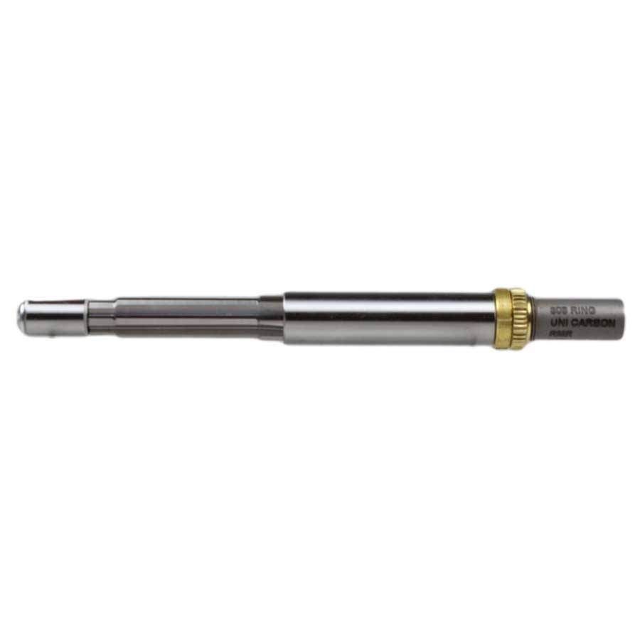

Kinda pricey but wondered if anyone has tried this? If so, would you think it would ruin a match chamber for LR/MR F class or even rim fire? (Assuming proper use and a light touch)
Seems that if a shooter sends a lot rounds down that same chamber it might be worth the $$......
