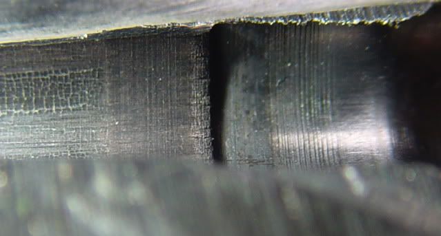

This a .204 with 2000 rounds down the tube. I let my coworker run 75 rounds down it before I cut it open.
Okey

Thanks for posting that pic. The carbon that is in that barrel is almost glazed on.
