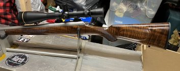

The Sako is a 20 Duster for calling coyotes and the Remington is a 20AR with a 13 twist that shoots the Berger 40 very well. I have to turn necks for both, Greg Tannel talked me into that facet of reloading. Today I would build no turn necks.

No sir, back then it was all that was available. The 40 Berger is relatively short and works well for this rifle and on coyotes.
The 40 VMax is absolutely too long and will not work.I was at high altitude too in Colorado and shooting them pretty fast. When it's time I will definitely get an eleven for this rifle. This rifle shoots incredible well but to look at the bore you'd never know it.Bore scopes are very helpful but sometimes I think many a barrel have been chunked too early because of them.
For those that are curious the 20 AR is the idea of Greg Tannel a .030" longer body length 20 Tactical this was conceived to make loading on his Dillon easier. I used the 33 VMax back then and let me tell you it clobbered rock chucks, coyotes and crows in the high country. In essence it performs like a well built .204.

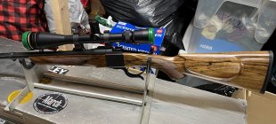

I decided to get into .20 caliber for PD shooting after shooting a buddy's .20BR on our 2008 trip to S.D. I wanted to match its performance using 30-30 case and Ruger No.1. I had been shooting a No. 3 in .219 Wasp for several years so I just necked it down and shortened the neck. I was very pleased with the results on our 2009 shoot. I was fire forming cases with 40gr V-Max at 4040 fps. Several hits at 500+ and two hits at 634 yds. The barrel is a Krieger 11" twist. A couple years later I had my No.3 .219 Wasp rebarreled to .204 Wasp with a PacNor 11" twist. Both barrels shot best with 39gr Sierras and 31.0 gr of N140 or Varget. When the 32gr Zombies by Hornady were available for about 10 cents apiece I had to try them. A mild load of 30.0 gr of Varget at a little over 4000 fps worked great out to about 400yds. Not benchrest accurate but plenty good for PD's and coyotes.
REALLY like the looks of that Wasp case! Outstanding performance to go with it. Thanks for sharing.
